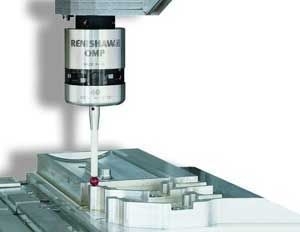

Method 9: CNC Probe
I’ve saved the best for last–a high quality CNC probe is more automated and can be more accurate than any other method. Probes go in the spindle and use a stylus tip to probe the part.
3D touch probes can be highly accurate.
Probes can be controlled via g-code and used for a variety of tasks. They can locate edges, the centers of holes or bosses, and all sorts of other things. Using the right G-code, you could completely automate the process of finding part zero. Just put the code at the beginning of your part program and the operator can drop a part in the vise, push the green button, and let the machine figure out the rest. It’s pretty amazing what these things can do, really. The main disadvantages they have is they’re going to be the most expensive method and the probes themselves can be damaged in a crash, which makes things even more expensive.
