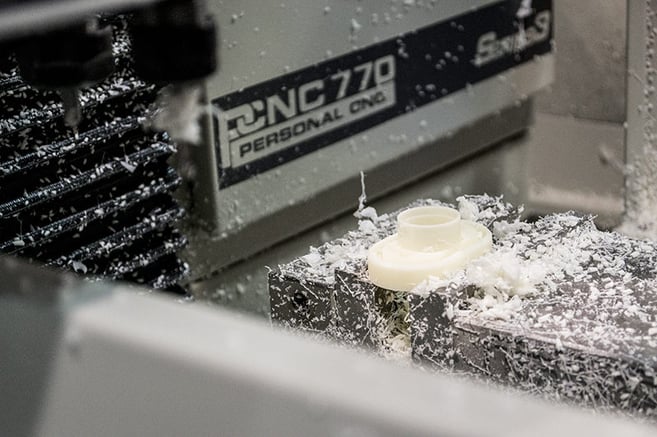

While you can still break a few tools while machining plastic, it is far more forgiving than metals and alloys. Because of this, you are far more likely to break the inexpensive plastic stock than you are to break a tool.
machining plastics
Feeds, Speeds, and Heat
When machining with metals, heat can sometimes be an issue that causes chips to weld themselves onto your cutter or your part – a recipe for cruddy surface finishes and lots of broken cutters. Plastics have a much lower melting point than metals, so lower RPMs and higher feeds are often optimal – lower spindle speeds cause less friction, while higher feeds keep the tool moving, preventing unwanted melting.
