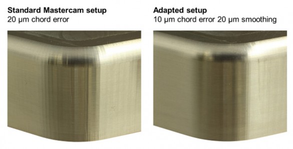

Most of the time, machinist’s focus on the hardware aspects when they think about surface finish: –  Do I have the right feeds and speeds? –  Is my setup and machine rigid enough? –  Is there too much runout on the spindle? This is definitely the right place to start, but it’s not the end of the story. A great many factors affecting surface finish are tied up in the CAD/CAM software used to create the part program. For example, the part in the photo on the right exhibits a faceted surface finish. This is definitely a software issue (although there are certain servo mis-tuning situations that can lead to that sort of thing). Let’s take a look at some of these critical software issues that affect surface finish:

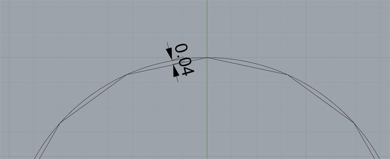

1. Chordal Tolerances

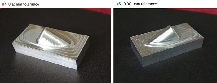

CAD and CAM programs will often simulate smooth flowing curves with a series of line segments. When this is the case, and it has to be the case for many kinds of curves because most CNC controllers only do lines and arcs and there are many more kinds of curves in the world, it’s important to look at what “Chordal Tolerances” are in use.   Note that your CAD and CAM programs may use alternate terminology, so follow along to understand the principles and then you’ll know how to recognize which parameter to change in your software. To understand Chordal Tolerance, think of simulating an arc with a series of line segments. The lines are chords of the circle, hence the term "Chordal Tolerance." The trick for surface finish is to pick a chordal tolerance that maximizes your finish while maintaining your part’s tolerances.   Since we have the luxury with computers of using as many line segments as we like, we can make the Chordal tolerance arbitrarily small. My CAD program, Rhino3D, defaults to a tolerance of 0.001″ with the settings I use because most of the time I’m not trying to make parts with tolerances better than that. While this may be sufficient for tolerance, it is very common to discover that good surface finish requires even tighter Chord Tolerance. Moldmakers may find they need to use a tolerance as low as 0.00004″ to achieve good enough surface finish. What happens if you don’t use a low enough Chordal Tolerance is you get a faceted finish, like the part shown at the top of this article. Parts like that one are ideal for testing different tolerances to see what works. Here’s another example, courtesy of Autodesk University: The part on the left, which is noticeably rougher, was cut with 0.12mm tolerance and the part of the right with 0.001mm tolerance.

It’s hard enough to get great finishes in 2 1/2D machining, but 3D is much harder. After all, you’re trying to cut a smoothly flowing surface with a ballnosed cutter that produces scallops. There are at least two key things to think about when 3D machining. First is Stepover. Robert Grzesek, the author of the MeshCAM 3D CAM software, wrote a great guest post for us on how to choose the best stepovers. It’s worth your time to give it a read, but here are the highlights:
  • The stepover should be between 1/3 and 1/10 of the tool diameter
  • Use a larger stepover, in the 1/5 to 1/3 range, for soft materials that cannot hold detail well
  • Use a smaller stepover, in the 1/5 to 1/10 range, for hard materials or materials that can hold significant detail like metal and jewelers wax
  • Use the largest tool that will allow you to machine your geometry
The second key thing is which toolpath strategies to use? Robert has also kindly provided us with another guest post on how to choose the right kind of toolpath for different 3D machining jobs. Take a look at the article, but it turns out that several strategies will typically have to be blended to deliver the best surface finish. Here is a software simulation of such a blending:

There are two. First, by all means, crank down those tolerances and do some experiments on curvy parts to see what’s needed to eliminate faceting and maximize surface finish. Also, try to find the limits of your machine’s controller. Look for the point where you’re feeding it so much detail that surface finish starts to degrade. These are obviously very valuable pieces of information, and they can only be learned by trail and error, so keep a record of them once you discover these limits. Knowing these limits tells you what you need to shoot for. The second answer is to optimize your g-code within those limits. It turns out there is a very useful practice called “arc fitting” or “line/arc filtering." The idea is to select a tolerance, and then combine line segments into arcs that approximate the lines within the tolerance. It’s sort of like Chordal Tolerance in reverse, but it works because most CNC’s can interpolate an arc very smoothly. The end result is much less faceting and much shorter programs that are easier on your poor old controller to run. In fact, you can set the arc fitting tolerance much close to your part tolerance instead of having to make it much finer. You’ll need some software to do arc fitting. Some CAM programs have it built-in, and you can Google to find various packages that offer it as utilities. Eventually, I will add it to G-Wizard Editor as well. And here’s the effect on parts:
The part on the right had chordal tolerances reduced to 10 um and smoothing to an accuracy of 20 um. Note the much finer finished that was achieved!

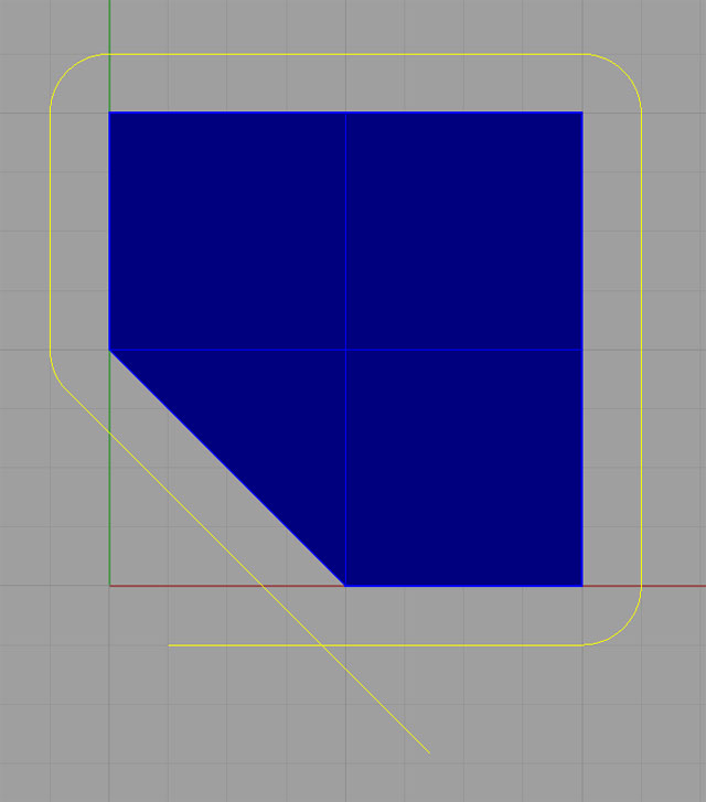

Change happens when we enter the material, leave the material, change direction from a straight line or smooth arc, and when we stop moving. Every one of these things disturbs the cutter in such a way as to leave a mark in the surface finish. Anything you can do to minimize the amount of the change will improve your surface finish. For example, the best CAM programs don’t change direction by issuing a G01 move in a different direction during the cut. They blend that change by putting an arc on every corner. It’s surprising how much of a difference something like that can make. Likewise, if we enter or exit a profile, don’t just make a move with the tool perpendicular to the wall–try to make the move tangential. If you can align the entry and exit tangentially on a corner, you’ll have the ideal entry and exit: Sometimes you’ll have to go through considerable gyrations to get your CAM software to line things up in this way, but it’s worth the trouble. If you can’t do the tangential moves, arc your way in. There are a lot of good strategies for entering and exiting cuts, and they’re discussed on the Toolpath Considerations page of our Feeds and Speeds Cookbook. Another possibility is to rearrange the toolpath so direction changes happen off the part. The ability to do this will be a function of part geometry, but if you can manage it, keeping direction changes off the part will reduce the witness marks that can mar surface finish. This post originally appeared on the CNC Cookbook Blog.
