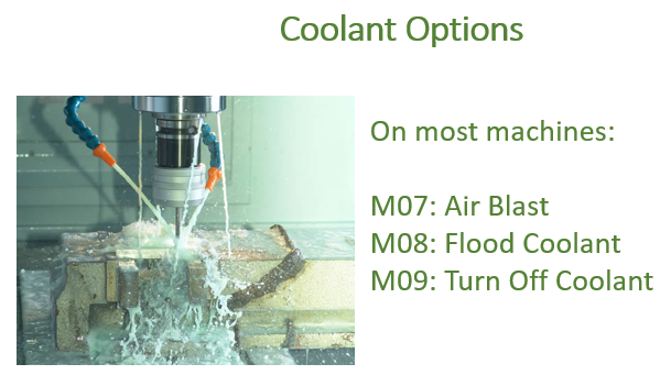

Coolant: M07/M08/M09
Good idea, let’s don’t cut without coolant unless we really understand dry machining, and even then, we probably want an air blast. There are definitions for what M07 and M08 are supposed to do, but I am not going to tell you what they are. People can hook up the machines to do all sorts of things. For example, M07 could turn on an air blast or mist and M08 could turn on full flood coolant. Suffice to say M07 and M08 turn on two different kinds of coolant. Give each one a try to see what it does. M09 turns off the coolant, which is another good one to know. That ought to do it. You should be ready to cut. But wait, there’s one thing missing. How about selecting a tool?

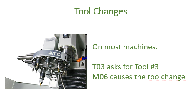

Tool Changing: T+M06
You could certainly manually insert a tool in the spindle taper. That’s not hard and you need to know how to do that. But if your machine has a tool changer, there’s a bunch of them sitting there and probably several would be convenient to access. With just two more G-codes, you’ll know how. Tool changing is a two-step process on a mill (and on some lathes, but most lathes don’t use the M06). First, you select the tool with a T-word followed by the tool number. Then you perform the tool change with M06. You can put them on two lines or write them together: T12 M06 Select tool in slot #12 and swap it into the spindle.
