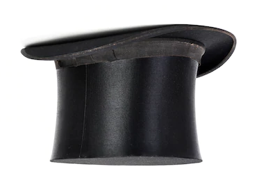

For instance, if we wanted to hold this top hat.
top-hat-model
If we reference both of the surfaces and run one hat, we are limited. At that point, if we wanted to run a hat that is taller, our second surface (datum) will be messed up.
top-hat-referencing-two-surfaces
If we reference both surfaces, that makes the dimension critical and locks us in.
top-hat-referencing-one-surface
If we reference only one of the two surfaces, then the hat height can vary.
top-hat-reference-here
If your critical dimension is the wall thickness of the top of the hat then reference here.
Parts will always vary, so you want to allow for that variance in as many ways as possible. Allowing for that variance will keep your fixture flexible, but also reusable and efficient.
