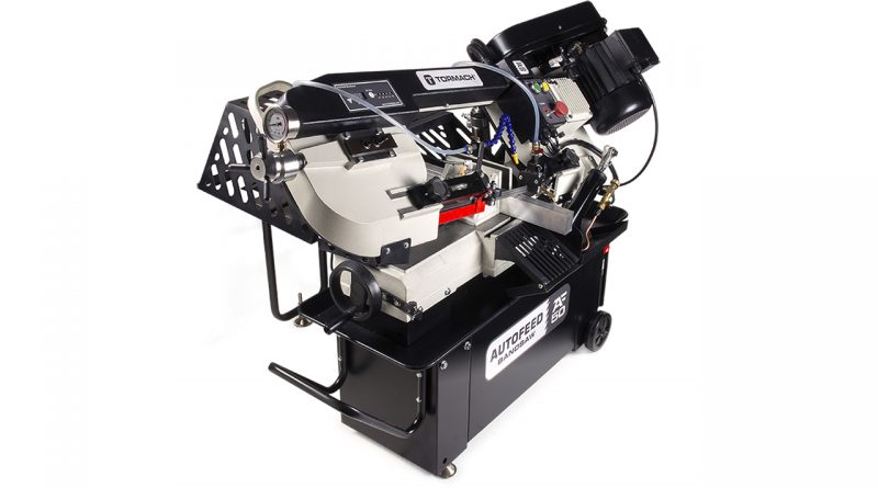

People that know Tormach know us as a CNC machine tool company. Our 1100 mill has been the flagship machine for our company for more than a decade, but we have recently made our way into the world of fabrication with our AF50 Autofeed Bandsaw.
Automatic bandsaws aren’t cheap. In fact, most cost more than a larger Tormach CNC mill!
That’s why we set out to develop an automatic bandsaw… in hopes of finding a way to help metalworkers and fabricators make cutting stock more efficient without destroying the budgets.

First is the raising of the saw itself. The AF50 uses a pneumatic cylinder to raise the saw system, every time you’re ready for a new part. That means less bending over and lifting the saw blade, which will not only save you time, but also your back.
Also, the AF50 features an automatic feed system (that’s where the AF in AF50 comes from). Basically, you can set a given length for your parts, dial in how many you want to cut, and let the hydraulic feed control do the rest of the work.
This means you no longer have to babysit your saw, or in a larger shop, you don’t need to pay somebody to stand there and cut stock. This also gives you flexibility to change the stock size, if needed, or to have stock on hand for a quick rush job

Like all of Tormach’s other machine tools, the AF50 operates on single-phase power (115 Vac), so it’s easy to find a place to plug it in. It also requires connection to 90-120 PSI, for the automation part of the saw.
The capacity is an impressive 7 in. round or 6 in. x 8 in. flat stock. That means you can cut some pretty beefy chunks of material. And it can handle anything from softer metals, like brass and aluminum to the harder stuff, like stainless.
Here are a few other specs:
  • Blade Size: 93 in. x 0.75 in. x 0.035 in.
  • Blade Speeds: 135-161-226-394 FPM (@ 60 hz)

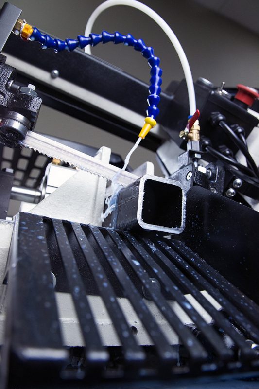

  • Integrated Coolant System - Coolant Recycling System
  • Blade Tensioning System
  • Adjustable Clamping Pressure (Soft Squeeze)
And the saw’s programmable automatic workpiece positioning system…
  • Cuts lengths between 0.157 in. - 50 in.
  • Up to 10 in. per stroke
  • Maximum 5 strokes per part
  • Maximum 999 parts per program
  • Features a part countdown display
