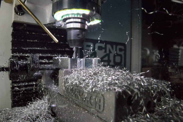

This is arguably the most important feature to consider when choosing an end mill for CNC machined aluminum. Again, aluminum is gummy and soft, which means it tends to stick in the flutes of your CNC mill. While coatings can help alleviate this issue, if you’re using a 4- or 5-flute end mill to cut aluminum, even the best coatings may not help. One of the main goals of flutes when cutting aluminum is to clear CNC machined chips. While having fewer flutes makes your tool less rigid, it also allows for more efficient movement of those chips. If you don’t get chips out of there, you risk ruining your surface finish, by re-cutting chips, or worse, destroying your end mill by friction welding the chips right to your cutter - every CNC machine owners worse nightmare! Your best bet for an end mill in aluminum is two or three flutes. While you can get away with more flutes, if you are really concerned about rigidity, your risk of destroying your end mill will go up.
