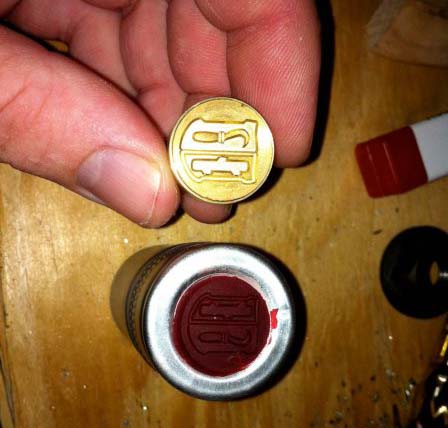

The blog has been on break a little longer than usual. Don't worry, we're still here - and lots is happening! PCNC mills helping to make Wine better! First, a very cool customer showcase from Tim at VinPerfect. They make wine closures for regulating the flow of oxygen into a wine bottle, and also testing fixtures of product R&D - manifolds and such. Tim made this great video that shows how he makes both the test chambers and the brass wax stamp. With the wax stamp, he's using an 90K RPM Air spindle.
More from Tim: Below are manifolds used to test oxygen transmission through the cap liner we are developing. The liner is seated into the recess you see at the top and the lids (second pic) are put over them. Underneath is flushed with 100% oxygen and 100% nitrogen is flushed through the top. There are optical sensor dots that will be adhered to the inside of a glass window on the tops. That sensor can detect oxygen on the part-per-billion level - which shows us how much oxygen is transferring through the liner. For wine - it needs a little oxygen to age well, but too much and too little are both bad things. I could not find a machine shop that was willing to do this for me for a reasonable price - and the 4 units you see being assembled here are the 5th version of this design. The Tormach has paid for itself several times over by now. I also use the Tormach for dies. We use a air turbine spindle (just goes in the tts collet - not an accessory mount) to engrave wax stamping dies for the top of the cap.  Tormach at Digital Machinist Workshop As I mentioned earlier, we will again be participating at the Digital Machinist CNC Workshop. Specific Tormach events scheduled:
