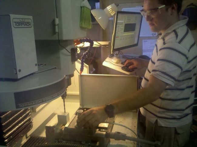

Owner of a Tormach PCNC 1100 with an ATC and 4th Axis, Crenshaw has been working on a research project for a single customer—the United States Fish and Wildlife Service.

Crenshaw said, “After making 3D concept models and getting them 3D printed, we used the PCNC 1100 to machine aluminum molds used to cast epoxy over electronics. Having the Tormach made this much easier because we could try various ideas without having to go to a machinist. The customer was very impressed with our responsiveness to design change recommendations. Between 3D printing and milling, our prototyping process is very quick. Ultimately it will enable us to deliver a product that the sea otter is comfortable having on its flipper.”
The PCNC 1100 also helped Desert Star Systems keep their budget under control. Identifying costs associated with complex-shaped molds, Crenshaw added, “The main design challenge for this project was the cost of machined molds. We have a good process for cylindrical epoxied electronic components, but more complex shapes need different molds. Making silicone molds from 3D printed parts was another option, but attaching the electronics to the mold prior to potting is a hassle to get consistent. Having an aluminum mold was ideal, but the cost of multiple iterations without a mill of our own would have really cut into the budget.”
