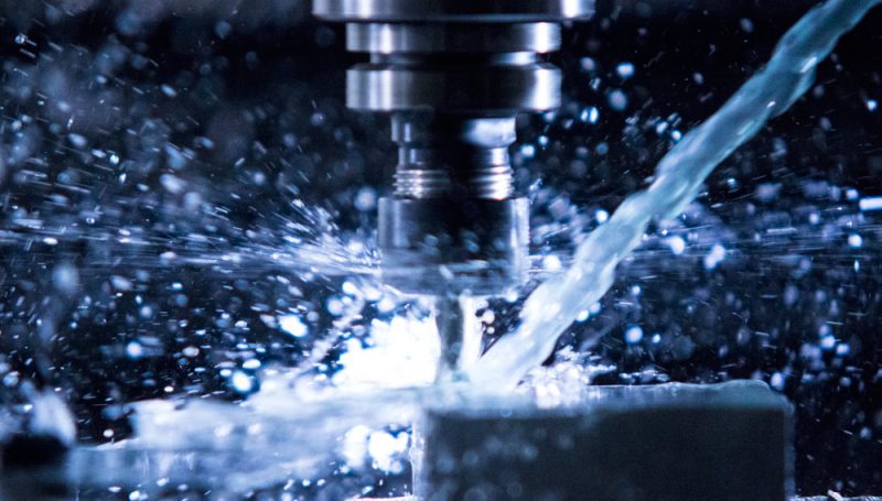

⅜”, ¼”, and ⅛” End Mills
End mills are one of the most common cutters for machine tools. They come in a variety of sizes, shapes, flute counts, and materials (as well as coatings), which make them incredibly versatile.
When we’re talking about aluminum, having ⅜”, ¼”, and ⅛” end mills will get you a solid foothold. Larger cutters allow you to get rid of more material faster and the smaller cutters give you the ability to add more detail, especially on ID work. Tormach technical support specialist Adam Brunner explains, “Think about it this way, a small tool can make a large internal radius but a large tool can never make a small internal radius.”
A couple other important things to consider when picking out end mills for aluminum is tool coating and flute count.
Aluminum has a tendency to be gummy, which means that getting those chips away from the part and cutter is important to stay efficient and keep a nice surface finish. Keeping some YG-1, 3-flute end mills with TICN coating on hand will make your aluminum cutting a breeze.
Three flutes gives you the ability to maintain a flute in the cut (efficient), meaning you can run the tool faster while still being able to clear out those chips.
