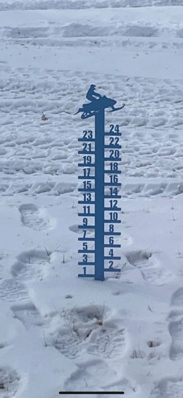

He’s a snowmobiler and realized that his like-minded riders would be interested in knowing exactly how much snow has fallen. “Every winter we have a yard stick at the cabin to see how much snow we got the day before. I thought, ‘Hey, why not make a neat snow gauge, everyone has a yardstick, I bet people would like one with a snowmobile.’ So when I came back from up North that Sunday, I sat down and opened Solidworks and started drawing.”

While his budget wasn’t massive, Bailey did need to have decent cut quality with his parts. The snow gauges are essentially art pieces, so precision wasn’t as important but the ability to keep finishing to a minimum was. “The cut quality is so good, I only need to run them across a belt sander a couple times and they are ready for paint.”

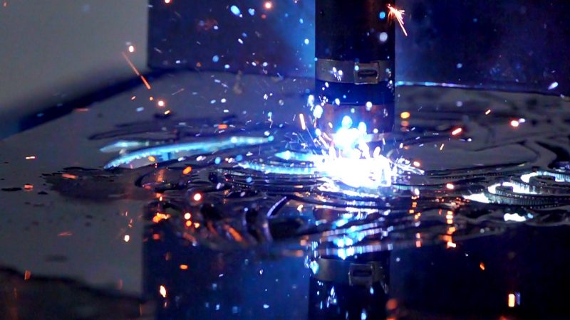

So far, Bailey has been pleasantly surprised by the consumable life of the Hypertherm plasma system integrated with the 1300PL. “I’ve used a mixture of FineCut and standard consumables so far, and have been getting great longevity out of them. My signs are incredibly intricate, which means lots of linear feet of cutting per sheet of metal.”
Bailey’s last production run was almost a linear mile of cutting and he used eight sets of nozzles and electrodes while cutting 1500 lbs of steel sheet.
Of course consumable life depends on the material you’re cutting, but Bailey’s experience gives a glimpse at how economical plasma cutting can be on the 1300PL.

Bailey explains that “my total setup time is maybe five or ten minutes. Because I use the entire work envelope, I know where to put the piece of steel. After you do a couple it's very easy to know where to put the next one, and with the Dry Run function in PathPilot, it's quick to check that you're right. The Dry Run button lets me run the program without the torch on, I use this to validate the G-Code file and my setup. Next I turn the dry run off, and hit cycle start and watch the sparks fly.”
Using PathPilot Hub Bailey was able to take the DXF file exported from Solidworks and transfer the file directly to the machine. “PathPilot has conversational programming which is another reason I choose the 1300PL. With DXF to G-Code I was able to easily select the order I wanted the lines cut, then post it directly to the machine. PathPilot did all the work needed to create the G-Code file and automatically load it so you are ready to start cutting.”
