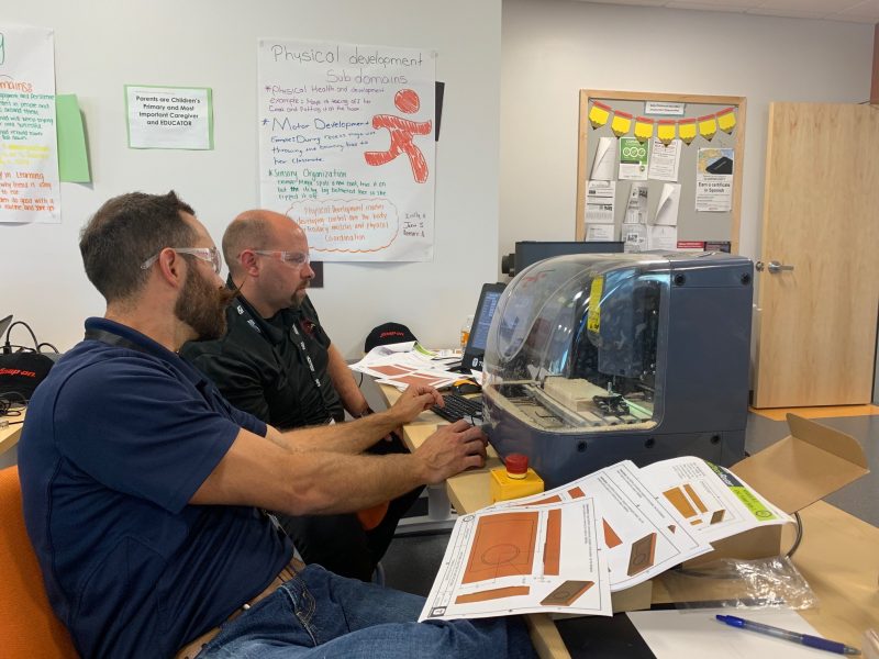

So often, teachers are burdened with having more kids than supplies, and CNC machines are no different. Not every school can afford to have 20 PCNC 440s for 20 kids. In fact, many educators are relegated to a setup that has something like 20 kids, but only a couple xsTECH routers and a single PCNC 440 or 770M mill.
This is where PathPilot HUB plays a pivotal role. While most of us can all agree, the best part of CNC is making chips, there is a lot more to the process than just hitting go and watching metal fly.
PathPilot HUB provides a full software interface for any machine in the Tormach catalog, which means, you can allow students to poke and prod at how the machine works before they ever touch the equipment.
In fact, according to a University of Iowa professor, "I was using the virtual HUB for my class these weeks. I found it is very helpful for teaching the students CNC programming." While his class isn't using a Tormach machine for physical production work, he said, "The virtual HUB makes the learning process very interesting. I think the students enjoyed CNC programming much more than previous semesters."
Once your students have proven out their code virtually, they can sign into HUB on your physical machine and sync the files down to run them. No more lines of kids waiting with USB flash drives full of unproven code!
Some of the educators using HUB right now are teaching classes of 35+ students at a time with 2-3 physical machines. Without HUB, most of the student’s class time would be spent waiting for access to PathPilot on a mill. With HUB, the students are able to create full conversational programs in the HUB simulator from their Chromebooks. Students only need to move over to the physical mills and lathes once they are fully confident in their G-code.
