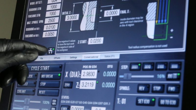

    It Still Runs on PathPilot
    Like all of our CNC machines, the 8L lathe will be controlled by the PathPilot system. That means you can use intuitive conversational lathe programming, do rigid tapping, and leverage built-in Dropbox™ support for transferring programs.
    PathPilot has been known to be incredibly powerful for both beginner CNC'ers, as well as veteran machinists. Lathe parts are often deceivingly difficult. While you’re only working with two axes (unlike a mill, where it’s three or four), turning can be surprisingly tricky. The lathe interface of PathPilot makes creating turned parts easier by using straightforward buttons and controls, simplifying the whole process.
