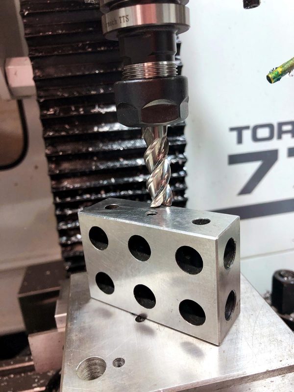

I thought that I would start off with one of the most widely used applications, especially in CNC. While touching off a tool with a sheet of paper to the workpiece and setting your DRO to .003” is very common, I have always been hesitant to use this method. My background is mold making, where Z0 is typically set at parting line (where two mold halves meet). The thought of dropping a carbide tool onto a precision ground surface with only paper as a buffer, makes me a bit squeamish. If I become overzealous with my handwheel, I could potentially damage this surface. My weapon of choice when manually touching off tooling is my trusty old 1-2-3 block. I would touch off, with just a hint of drag on my block and enter the offset as 1 inch, 2 inch, or 3 inch, depending on the side that I chose to use. You can also verify tool measurements with this method. Calling up a tool and directing it in MDI to travel to Z3.0 will allow you to check your offsets within a safe distance from the top of the part.
