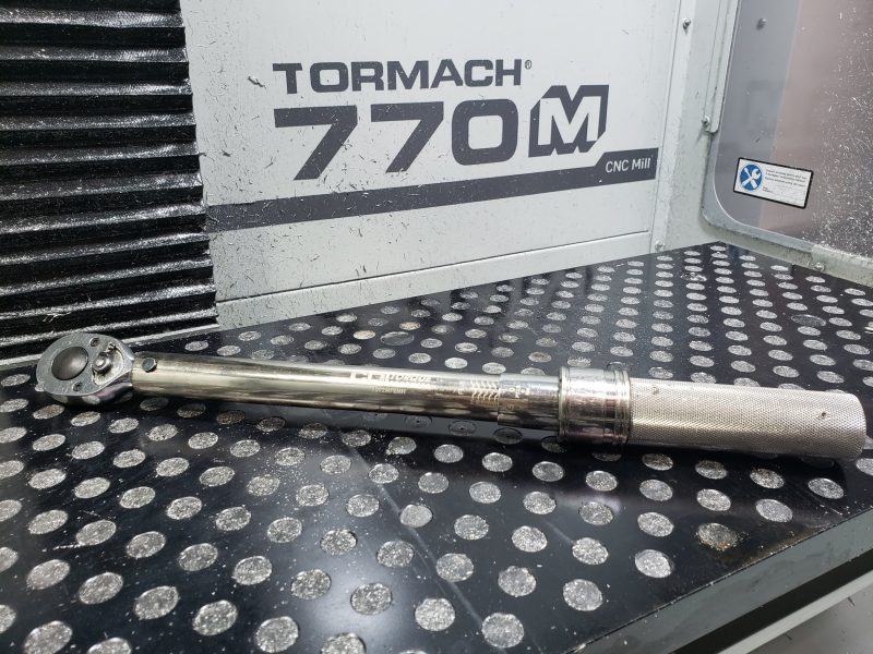

Use Torque Wrenches
Using a traditional vise handle makes it easy to tighten a vise but fails to address to key practices:
1) Tightening with the correct amount of torque
2) tightening with a consistent amount of torque.
Luckily, torque wrenches make quick work of solving both of these problems.  Applying the same amount of torque each time allows for dialing in of variables and factors such as law lift and deflection.  Pro tip: only use your torque wrench to tighten the vise.  Use a ratchet wrench modified to only loosen to open the vise.

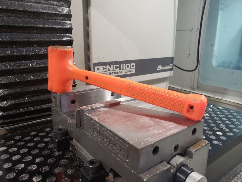

Hammer (Most of the Time)
One of the most important factors to consider when machining is rigidity. Rigidity of your machine, tooling, and workholding are all factors to consider. Vises are great at holding your parts, but don’t offer an accurate, repeatable means to locate your part, particularly in height and parallelism to the table.
Parallels allow for the part to sit coplanar with the table of the machine. But be aware, just because the part is flat on your parallels before tightening the vise does not mean the part did not lift after tightening. A solid hit from a dead-blow hammer will ensure the part is flush on the parallels and minimize any small jaw lift (see below).
A quick way to check if your part is seated is to try to slide the parallels sideways under the part. If the part is seated, the parallels should not slide easily. DON’T use a hammer when fixturing with tools such as Mitee-Bites TalonGrips or Pitbull-style clamps. These are designed to bite into the edge of the part and even add clamping forces in the Z direction in the case of the Pitbulls. A hammer blow after clamping can actually loosen the bite into the part instead of making the part flush.
