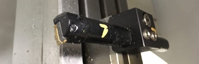

There are five types of lathe tooling: External turning tools, boring bars, drills, threading tools, and parting tools. First, let’s talk about external turning tools. They are great at just what the name implies, cutting away the exterior of your piece. This include roughing or finishing work. Second on our list was boring bars. You can recognize these by their circular, bar design. They come in a bunch of different sizes, with one main purpose – to make an already existing hole bigger or to refine the finish of hole.
boring-bar
Boring Bar secured in gang toolholding set up.

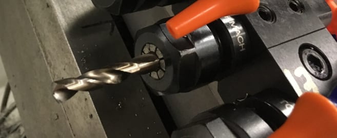

To make that initial hole, you’re going to need a drill. If you’re new to lathe work, you can picture this as a power tool drill, but instead of the machine spinning the cutting tool into the workpiece, it’s the exact opposite. The workpiece is moving really fast and the drill is secured in a stationary position. The holes boring bars make have a rougher finish, but if you’re going to thread it later on, that’s perfect.
drill
Drill secured in gang toolholding set up.

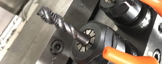

Threading tools can add threads to both the interior and exterior of your workpiece. For instance, if you need to make a workpiece that you can thread a screw into, you can use internal threading tools after pre-drilling the hole. If you want to make the screw with threads, you can also do that with external threading tools. You’ll make to make sure in both cases your CAD and CAM programs include a threading operation before you press go.
threading-tool
Threading tool secured in gang toolholding set up.

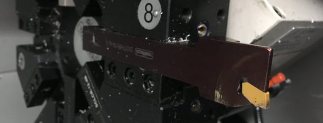

Lastly – we have parting tools. Parting tools are also very important, and do much more than their name implies. These tools can part, groove, and cut off workpieces while offering a consistent, smooth finish. This is what you’ll be using a lot of if you’re doing detailed exterior work.
parting-tool
Parting tool secured in turret toolholding set up.
