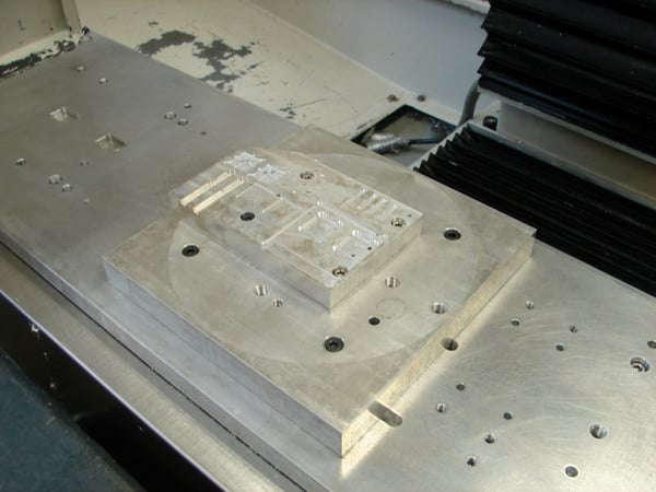

  • A second fixture plate is design to accept the dowel pins on the table.  Additional pins on this plate are used to locate the vise.
Vise Pinned to Fixture Plate Vise Pinned to Fixture Plate
  • On this same plate, slots have been milled to accept the 4th axis Table.
4th Axis Pockets on Fixture Plate

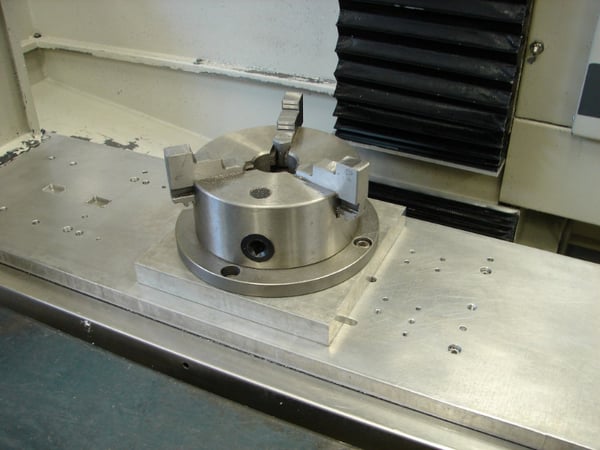

  • With the vise removed, another smaller fixture plate can be mounted that accepts a 3 Jaw chuck for holding round bar stock vertically.
3-Jaw Chuck Mounting Plate 3-Jaw Chuck Pinned to Fixture Plate

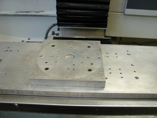

  • The same plate also takes another smaller fixture plate as well.
Stacked Fixture Plates
