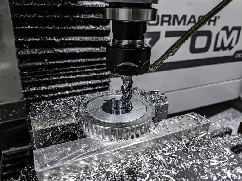

Don’t Touch the [End Mill, Part, Tool]!
Anytime you feel inclined to grab a workpiece or pull a chip off of a cutting tool: Don’t!   Stop and ask yourself:  1) Should I be touching this? and 2)  would I be better off using [pliers, scribe, gloves, etc].    A freshly cut part can have sharp edges, chips, and even microscopic razors.  Brushing your hand across the part is a sure way to start bleeding.  Likewise, never (never!) touch a cutting tool in a spindle whether stationary or turning.  End mills are good at what they do for a reason: they are sharp!   Anytime debris, swarf, birdsnest, etc needs removed from a cutting tool, stop the spindle and use pliers or a short stick to keep your digits in tact.

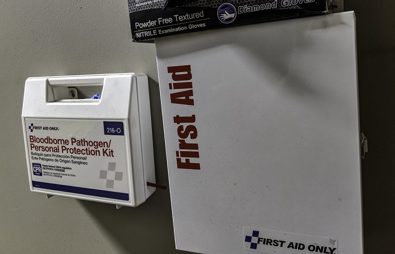

First Aid and 911
Keep a well-equipped first-aid kit at a readily accessible location within the shop.   Furthermore, when working alone, please keep a phone on your body so that you always have the ability to call for help if you are stuck or severely injured.   Finally, if your shop has the type of equipment that can cause catastrophic limb injury, consider keeping some tourniquets throughout the shop – preferably mounted to the wall no more than a few feet up.  It may sound far-fetched, if you have to crawl over to access a tourniquet, it may well save your life.
