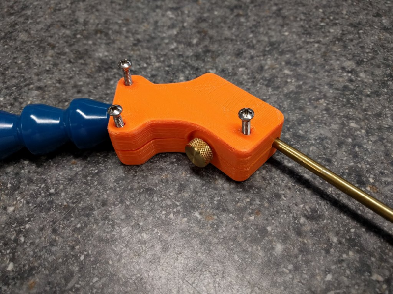

Upgrade the Mount
The stock mount for the Fogbuster isn’t always ideal - it leaves much to be desired as far as adjustability, so using a mount similar to a dial indicator base works wonders. 3D printable enclosures are also available that allow mounting on adjustable and flexible hoses.
The 3D-printed mounts we use.

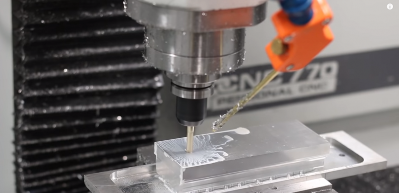

Where to Mount the Coolant Canister
The best place to mount the Fogbuster canister is just below the spindle at its lowest point.
Equally as important is how your coolant lines are run: you do not want them arcing up over the top of the machine and back down to the Fogbuster head. This will make it difficult for coolant to travel from the reservoir to the nozzle unless the air is on full blast.
Once the air level crosses a certain threshold it will be strong enough to pull the coolant to the nozzle, but cause an excess flow since the nozzle is open.
Another important thing to consider is not mounting your canister above the Fogbuster head. Air power and capillary action move coolant to the nozzle, gravity will only cause an excess of coolant flow as well as possible leaks from the head when the machine is not running.
The Fogbuster mounting location on one of our Tormach 770M machines.
