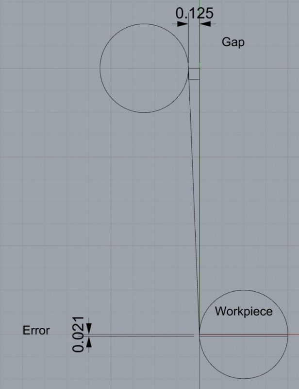

This is a good opportunity to use your CAD program to figure it out. Most CAD programs have a function to draw a line that is tangent to two curves, so I laid out the problem like this:
I drew a 1″ diameter workpiece and put a vertical line tangent to it. Then, I went up that line for 3″, where the top of my 6″ rule would be, and drew a 1/8″ square to represent my Mark I Eyeball’s ability to spot the rule being off. You can probably see an error of less than 1/8″, but probably not 10x less, so this suffices.
Next, I drew another 1″ diameter circle right on that 1/8″ gap. Lastly, I let the CAD program draw a line tangent to the two curves. That line represents the rule cocked at the right angle. Now zoom in to see the endpoint of that ruler line. I put a dimension from that endpoint up to the centerline and got an error of 0.021″.
Easy to calculate the crazy things by sketching them out in CAD (I use Rhino3D and Solidworks for my CAD).
But what about that error? I’m guessing we got down to more like 0.010" or maybe even 0.005″ when we set up the tool. Of course this begs the question, “How close does the tool tip need to be to the centerline when turning?”

Sandvik says you want to be within 0.1mm (0.0039″). This is a decent starting guideline. To achieve it, the end of your 6″ rule must be off no more than 0.023″ instead of 0.125″ from its ideal position.  A useful trick is to find a surface you can site the edge on, much as I suggest when using a straight edge to tram vise jaws on the mill. With a slant bed lathe, it may be hard to find a surface at the right angle.
A little reflection about the geometry will tell you that the diameter of the workpiece affects the allowable error in setting the tool tip height. Smaller workpieces need the tip to be more accurately on the centerline. I found one university source that recommends the tool height be set to centerline with an accuracy of 0.005R, where “R” is the radius of the workpiece. So, a 2″ diameter workpiece needs a tool height to centerline difference of no more than 0.005″.

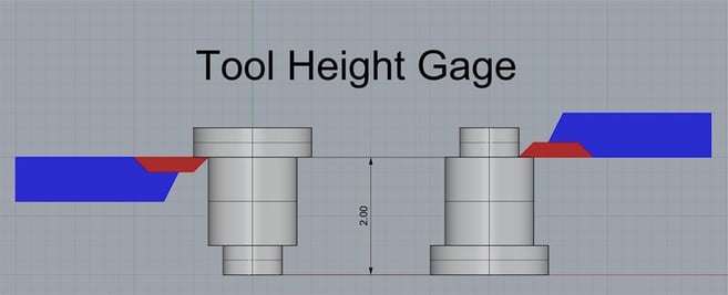

If you have a height gage and room to use it in your lathe, this is pretty straightforward. Turn a little piece of scrap and measure its diameter with a micrometer. Using the height gage, measure the distance from a reference, such as the tooling plate, to the top of the workpiece. Subtract half the diameter and you now know the distance from the reference to the lathe centerline.
With that information, you can either continue to use the height gage to set heights, or you can make a gage that is exactly that length and is used as a stop to set tool height. An ideal gage has a surface suitable for setting either the top of the insert by coming up against the bottom of the gage surface or the bottom of an upside down insert by coming down onto another gage surface. Something along these lines will suffice:
A well-made tool height gage can be accurate to a few tenths and can be stood on either end to allow setting height from the top of bottom of the insert depending on the orientation in the tool holder. You can even make a couple to experiment with different offsets above, below, and right on the centerline.
