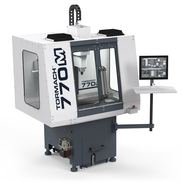

Adding a mill (especially CNC) to knife making isn’t for everybody, but it definitely has its perks. “The big jump after buying a belt grinder is buying a mill,” Sorrells explains. “Mills are the king of the metalworking shop. They’re a huge force multiplier for the knife maker. They help you work faster and more accurately. Once you decide you need a mill, the question you face is whether to buy a CNC machine or a manual mill. The choice comes down to your business plan.”
If you’re looking to do overtly customized and hand work, then CNC might be overkill. “But if you want to make standardized designs and sell them in volume, a CNC machine – something like the Tormach 770M -- is pretty much a no-brainer. They not only help you work faster, but they’ll help you accomplish things you just can’t do any other way.”

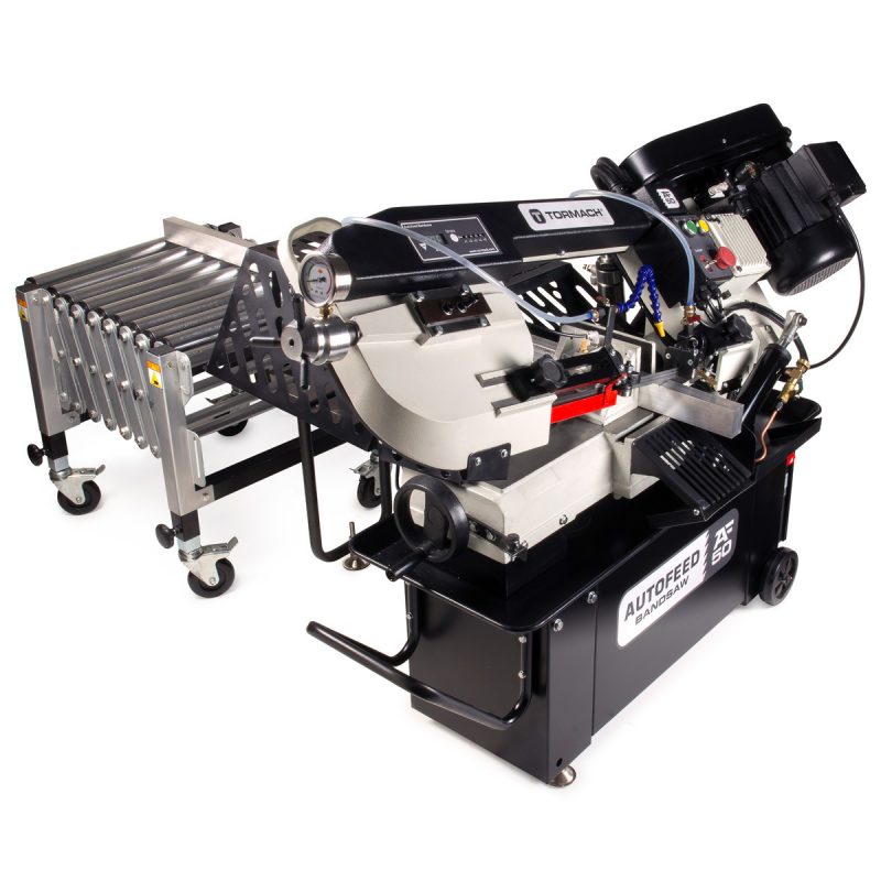

If you’re expecting to get into high production knife making, Sorrells thinks there are a couple other tools that might help along the way. Tormach AF50 Automatic Feed Bandsaw and 24R CNC Router would both be useful, if you’re looking to make a lot of knives. “Obviously, some of this would be overkill if you're just starting a business as a knife maker,” he explains.
