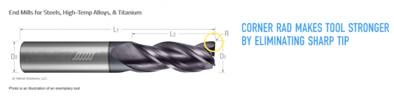

    End mills with a small corner radius are some of our favorite tools!  The small corner radius – usually 0.003” to 0.005” (0.07mm to 0.1mm) gets rid of the otherwise weakest point of a cutting tool: the sharp, unsupported corner! The radius is small enough to be insignificant for many machining operations – and, in fact, can have the benefit of leaving a small fillet in your part, reducing a possible stress-riser from a sharp inside corner.
    Our “Tool 31” general use endmill is a ¼” LSC 3 flute endmill with a .003” corner radius that finds its way into nearly every one of our operations because of its durability and versatility.
