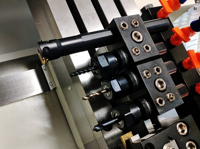

While you can mount a conventional manual lathe Quick Change Toolpost (QCTP) on a CNC lathe, this is typically only done for toolroom lathes. For production lathes, tooling is generally mounted either on a gang plate or on a turret. Ironically, the picture shows both formats in use, each turret tool station has a gang plate mount, which multiplies the number of tools available from each turret position. Pure gang tooling is the simplest option. In this mode, the tools are mounted in a row on the lathe’s cross slide. Accessing a tool is a matter of pulling back from the work piece along the spindle’s axis to keep the tools from colliding, sliding the X-axis until the correct tool is in position, and then moving along the Z-axis back to start cutting. A gang slide typically looks like this with the tools mounted.
The video captures the simple motion of the gang tool change as well as the speed of a tool change well.  Notice the two tooling formats–the rough turning tool is taking a big deep cut and is a typical square shank lathe tool holder. The rest of the tooling uses a round shank with a flat that is more typical of gang tooling. It’s more compact and sometimes you’ll even see a single holder mounting two inserts to be used for different tasks.
